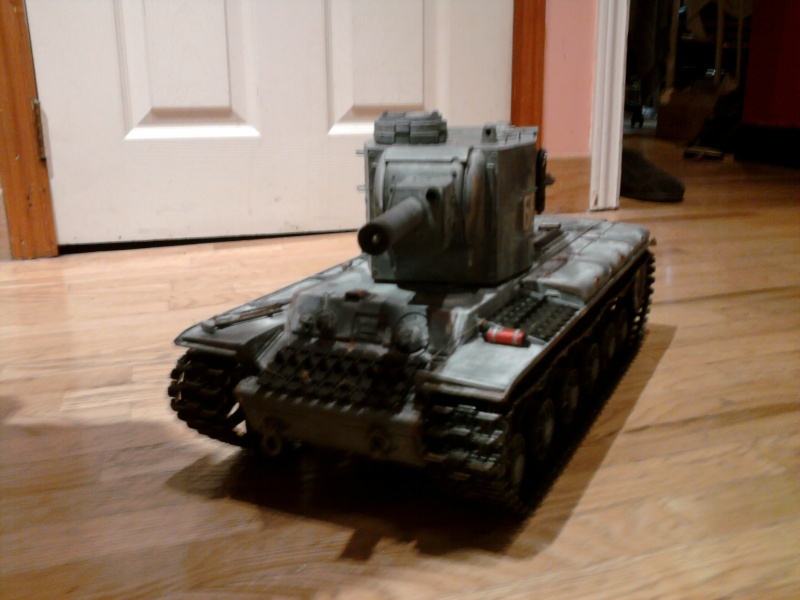

I mentioned earlier I refinished my KV-2.. just a little bit, added some wear, battle damage, and I tried to simulate what several Molotov cocktail attacks would look like, as it seems in the winter of 41-42 would be a very likely attack on a KV-2
Strato's KV-2 Build - Page 3 20130516
Strato's KV-2 Build - Page 3 20130517
Strato's KV-2 Build - Page 3 20130518

looks pretty cool i like it nice job

Not to shabby good sir i think this the most terrifying thing possible to have russianing at your tank! Kind of reminds me of a ghost ship.......

wow does that look like a piece of junk..........i love it cheers

Did you search Molotov cocktail on google while researching for damage picts? Next thing you know men with nice FBI jackets caps and sunglasses will want to "visit" with you! Lol you're so screwed! Lol j/k lol!

That's pretty neat effect, now you have to tell us how you did it.
I'm guessing you either torch it a bit or spray thinner?
Posts : 2035
Strato's KV-2 Build - Page 3 Empty
PostSubject: Re: Strato's KV-2 Build   Strato's KV-2 Build - Page 3 Icon_minitimeMon May 13, 2013 3:16 am
Thinner AND a hobby torch, works wonders. I still feel like the colour is spread out too uniformly, but I'm happy where it is now Very Happy
