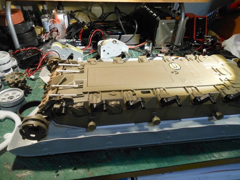

HL T-90 lower. Just some minor inserts and shimming on the side and front and back. It will have an IBU2U with T-72 sound file.
Another Trumpeter RC Conversion - T-72B Dscn1952
