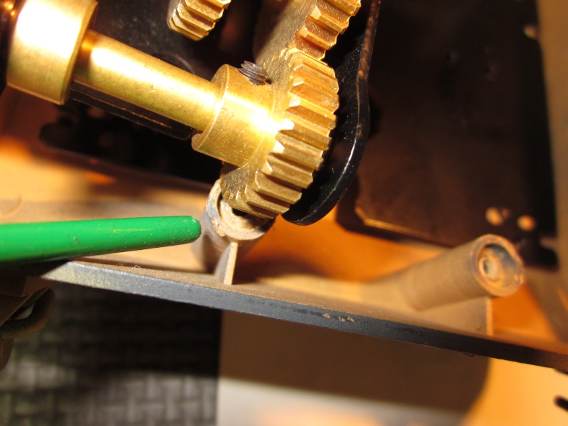

I wish I had something better to report however, here's the developments;
- received the gearboxes today, well packed, packaging intact.
- one gearbox had a bent output shaft even though the packaging was totally undamaged
- IMHO, these will not fit the Panzer IV, see pictures. Basically, there is a spacial conflict between the gearbox assembly and the two posts in the front of the Pz IV hull.
I have sent this off in some emails, we will see how this works out, I will report on what transpires.

We have confirmed that Waltersons was in error, when they said the gearboxes fit the Pz IV.
Curtis at Immortal Hobbies has stopped selling these for the Pz IV.
Wlatersons will be coming out with a PZ IV gearbox, but like other new releases, we cannot be sure when, until it actually arrives.
Curtis has offered to replace the defective set with another set of my choice, Pz IV or Panther. Since the exact delivery for the Pz IV is not certain, I am opting for a Panther set for the JP.
Curtis has offered my a set of 480's at a good price as a good will thing due to my troubles, that is why I had a post about 480's.
IMHO, Curtis is dealing with this whole thing quite well and appears very interested in straightening things out.
And, the gearbox quality looks to be quite good.

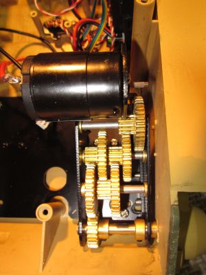

I have ran into a gearbox problem with my Jagdpanther.
The left gearbox motor is higher than the one on the right, it is the cause of the fit problem because on my JP the shape of the upper hull varies from the Panther G and the top of the motor, 480 or stock Waltersons makes contact with the upper hull.
The first picture shows the mounting of the left motor (pinion missing, this was a test fitting), it has the stock Waltersons motor.
Waltersons Gearboxes Img_1010
The second picture shows the gap in the joint between the upper and lower hull that cannot be closed.
Waltersons Gearboxes Img_1011

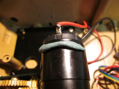

The third picture shows "Blue Tac" usd as a fit indicator.
Waltersons Gearboxes Img_1012

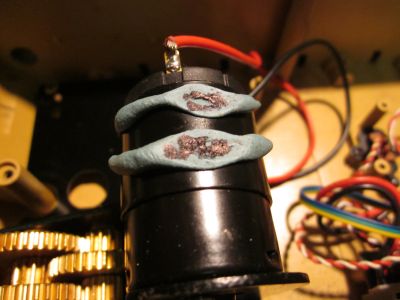

The fourth picture shows the Blue Tac compressed from contact with the upper hull.
Waltersons Gearboxes Img_1013
The fith picture shows some Blue Tac with ink on it.
Waltersons Gearboxes Img_1014
The sixth picture shows the upper hull where the ink was transfered to it from making contact with the top of the motor.
Waltersons Gearboxes Img_1015
As I see it, there is not much to be done to correct this and so I will cancel my JP IR conversion.
I have established that the Waltersons with 480's will fit a HL Panther G so this will be going in one of my existing Panthers.
