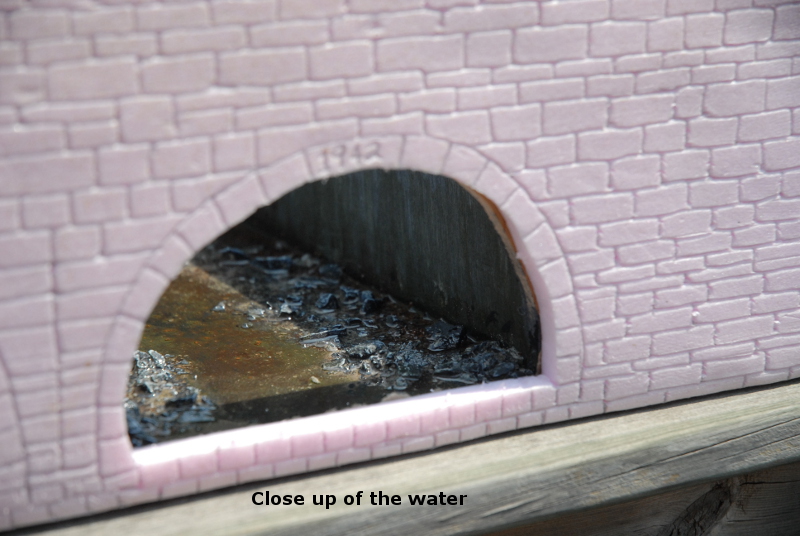

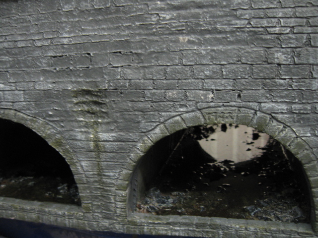

I figure a muddy river would look good under the bridge but, lol remember that creative side?  Well, I don't have it, unless you forgot.  I ask my wife who is pretty good with the artsy fartsy thing.   Yea, well, that's not good either.  She tells me that making water look like water is not so easy and blah blah blah.  Ok, I'll do it myself.  Yikes.
Go to Youtube, that place has everything.  Seems everything I research is beyond my painting ability.  At this point, after looking at no less than 20 videos or so, I figure I'll just wing it.  Worst case scenario is that is can make good firewood if it turns out like crap.
I'm now getting the feeling that this 1 day job of building a bridge is kinda run into a weeks project instead of days project.  Do you ever get the feeling of being halfway through a job, it's taking way to long, but ya can't stop now, feeling?  Yea, well, that's where we are at.
Onto painting the muddy river bed and the walls on the inside of the arches as I figure I can't paint them when the bridge is assembled.
Pictures to follow...

Back to work on the bridge walls.   I call around to see if I can get 1/4 in thick high density foam and no one seems to have the stuff in pink or blue, just the low density white stuff which will not work for what I want to do.   I do find some 1/2 pink stuff so that will have to do.
I set out cutting the shape of the bridge and the holes for the two arches.  Remembering I will need to add a section to the ends as mentioned earlier, I make sure this is in the design I cut.
As you can see in the picture, I had planned to cut a section out when I realized it was right over top of the arch and would have really made it too weak with the lack of material.
Like this.
Stingers Bridge Build Bridge38
Now that the basic shape is done, I set out drawing lines very lightly across the foam for my bricks.  I make sure the lines are not all equal in thickness as I don't want it to look to uniform.
Stingers Bridge Build Bridge39
Once the lines are drawn, I start drawing the bricks, one at time.  Yes, it's a long tedious job.  Each panel takes about 2 1/2 hours each to do.  Here are some pics of the first finished panel.
Oh and...  that's not a really a kitchen table I'm working on, ummm  it's my work bench, honest...
(looks around to see if wife is reading this...lol)
Stingers Bridge Build Bridge40
Time to temporary install the wall onto the bridge for fit and to see how it looks.
Stingers Bridge Build Bridge41
The bridge is starting to take shape now and is lookin pretty good so far.    Here are a few close ups of the bridge and new water features.
Stingers Bridge Build Bridge42
Stingers Bridge Build Bridge43
Stingers Bridge Build Bridge44
Stingers Bridge Build Bridge45

Painting the bricks...
Before I set out to paint the bricks, in one of the Youtube videos, it mentions about hitting the foam with heat from a heat gun to give it a wavy texture.  Of course they didn't mention they were using 2" inch foam.
I applied the heat, maybe a lil too much heat for the 1/2" foam and sure enough it created a bit more of a natural look texture.  Although I would warn you, do not to use too much heat on this thin material as it can ruin you project really fast as it almost did mine.
I've taken some water base paint (grey) and painted the foam bricks.  Once the paint was dry, I dry brushed the brick with some white paint to give it some highlights.
Being that the bridge is over water, I added some more of my famous green moss to the some of the brick on the bridge to try and give it a more realistic look.
I glued the walls on with this stuff.   Thick consistency, 15 minute work time and does the job.
Stingers Bridge Build Bridge58
Whatcha think ?
Stingers Bridge Build Bridge56
Stingers Bridge Build Bridge57
I cut 1/4" x 7/8"  plywood for the top cap, mixed up my own concoction of paint with the left over Tan, white & Black I had laying around.
Stingers Bridge Build Bridge59
Here's a sneak peak of the wall with cap installed.
Stingers Bridge Build Bridge60
The bridge build is almost coming to a close.  Just need to finish with the cap.  Some finishing touches to do and we are almost there.
I'll post some pics with the walls glued on and the cap in place soon.
