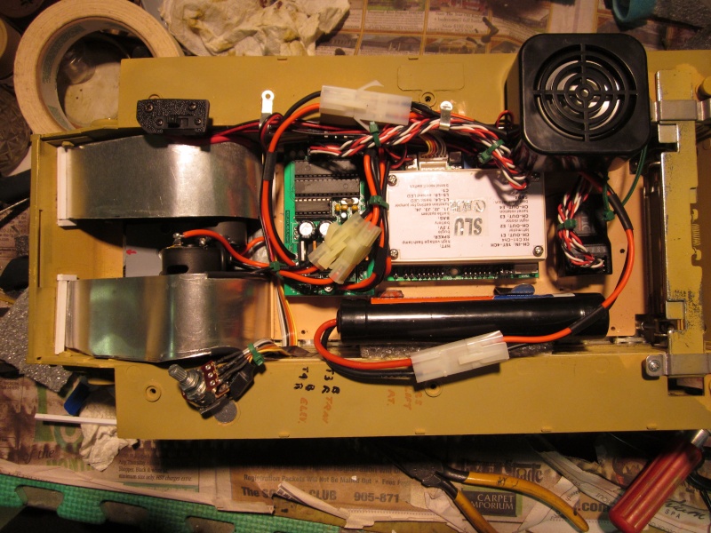

| Interior of the lower hull Initial painting NO markings, accessories, weatheing, clear coat, etc.; lots more to do; _____________________________________________ "Luck favours the prepared!."

| Hey Glen are those gear covers metal ? Is the spring tension holding them in place? |

| - knispel wrote:
- Hey Glen are those gear covers metal ? Is the spring tension holding them in place?
They are aluminum dryer duct material. Not real springy but they have enough tension to be held in place. I have taken 12g wire insulation, split it and glued it on the edges where the motor wires contact it, to prevent damage to the wiring. They should be handy since no tools are required to remove them, making checking the gears easier to do, especially since thew upper hull is easily removed on the Taigen Tiger I. _____________________________________________ "Luck favours the prepared!."
