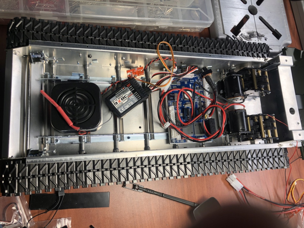

| Quick update. Got some pieces from AFV via RCtank.de. Gun elevation unit frame and front radar rotation and elevation unit. Still have to put in own servo and mechanicals for the gun elevation as well as rear radar rotation. Not going to put in rear motor elevation as there is currently already 4 servos in the turret (nano 360 for rear radar, Full size servo for gun elevation, nano again for front rear elevation and micro 350 servo for rotation). Also DIY turret rotation and thanks to Big Mike for the turret ring ! Thanks Mike for the 3D turret ring. Full size servo for gun elevation, the AFV frame for internal mechanic's and the bottom of the front radar rotation unit. |
MikeC Field Marshal
Posts : 3047 Join date : 2013-08-25 Location : Toronto, Ontario
| Subject: Re: Gepard parts Tue Nov 24, 2020 3:50 pm | |
| Top of the front radar rotation unit Nano 360 servo embedded in the rear radar unit. Display model Leo 1 chassis. I was told that Gepard is a little shorter but can't tell. Heng Long gear set with IBU2U Leo 1 sound. |
